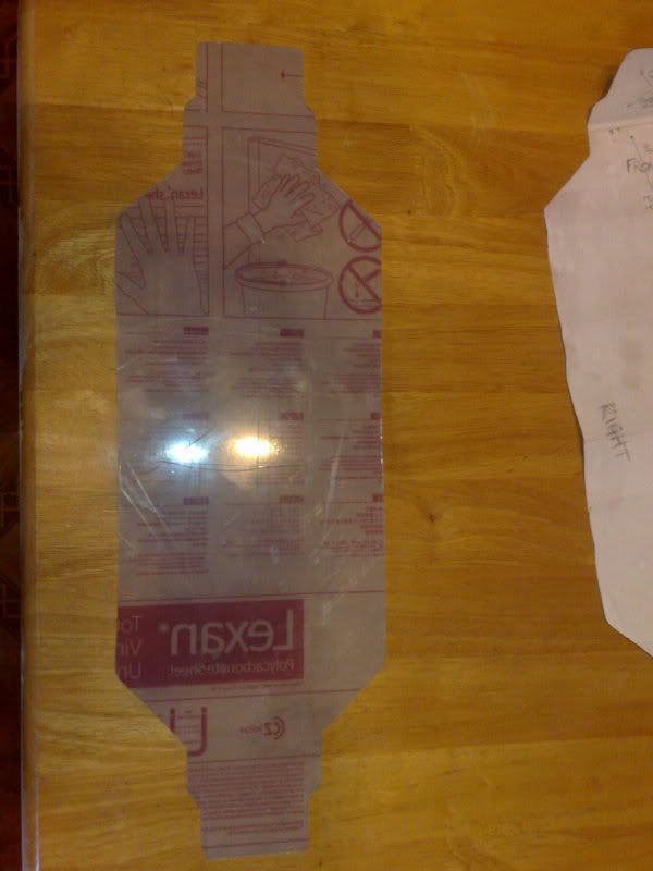

made me an underskid
from 4mm bullet proof perspex
an today,i have FINALY got around to sorting it out
ready for mounting
i marked an drilled 4 holes front an rear,using 4 of the 5 diff screws
these where drilled an then counter sunk
i also drilled the two holes for the engine chassis bolts,so that if needs be,the engine can be removed,without the need to remove the whole under skid
also i marked an drilled the 4 front holes,for the front bumper (didnt need counter sinking)
it was then mounted up to the chassis
the front bumper was then refitted to finish the job off
its now finished an ready for testing
if i dont get any done this week
then the bash is next weekend
so it will certainly get some there
