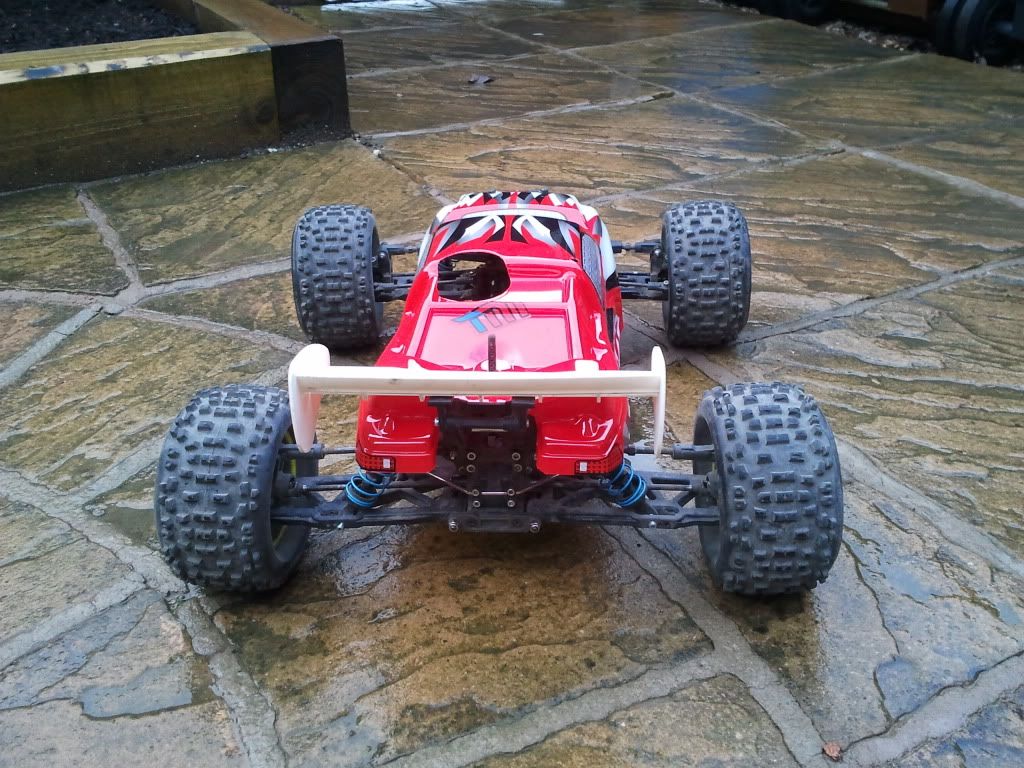

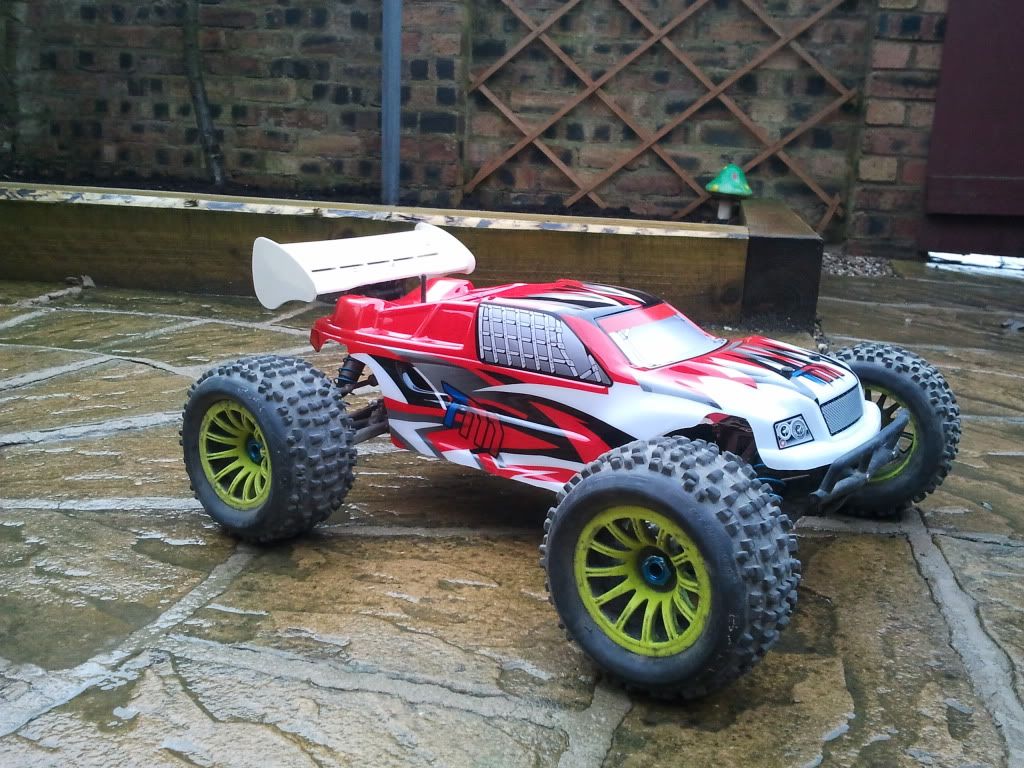

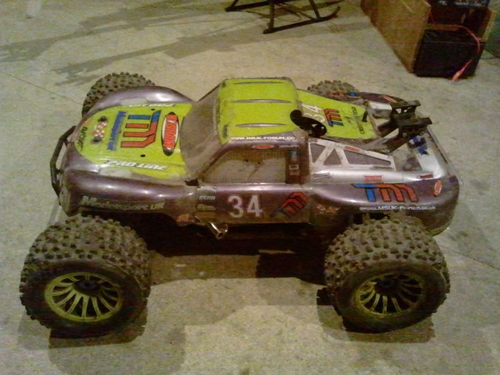

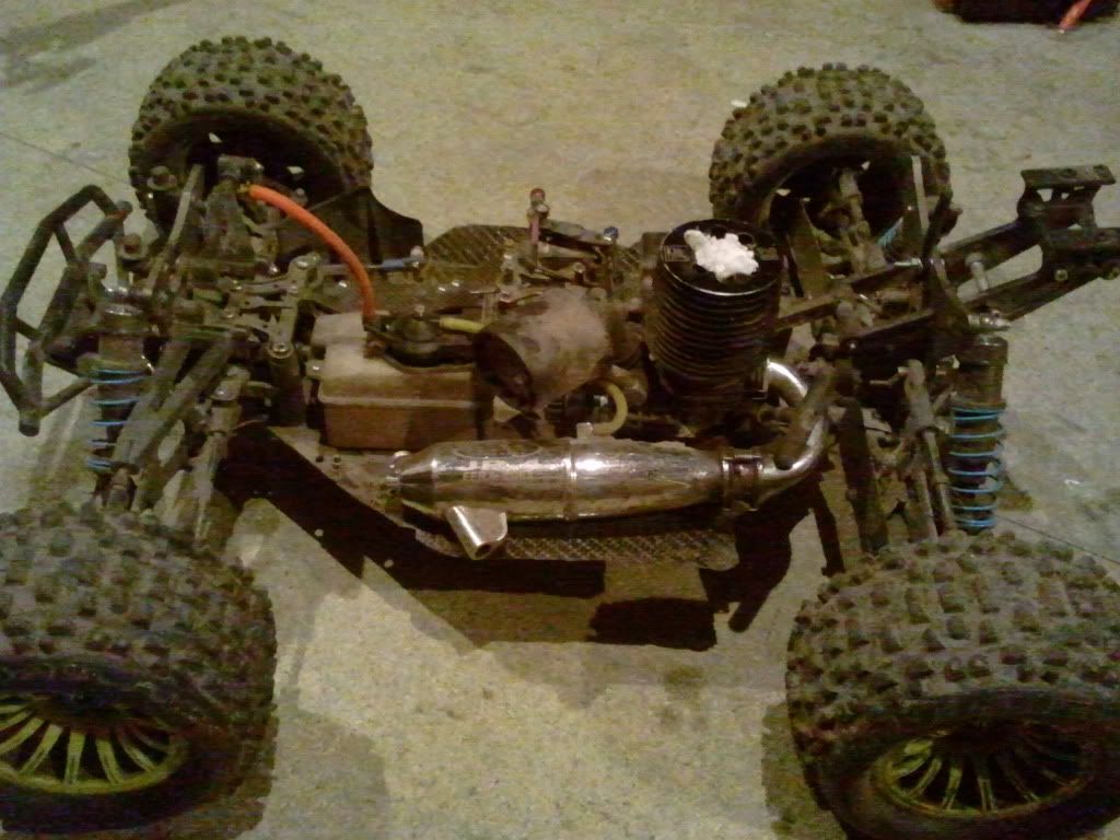

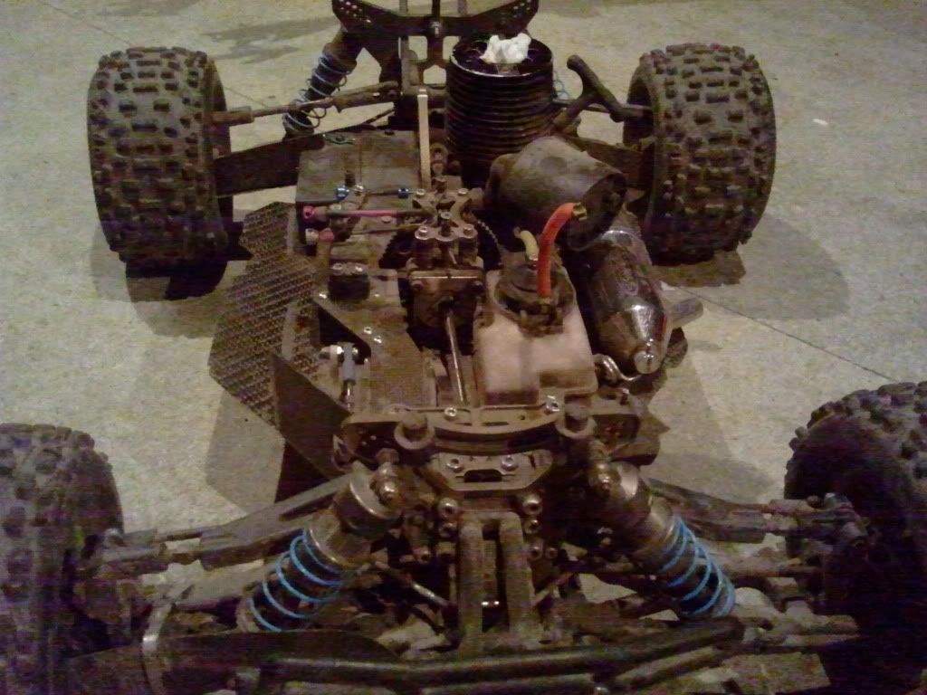

Well I have just come into possession of a CRT Pro
It used to be Jay's, but it hasn't come Via himself
It did however come in a bit of a state, and in need of some attention

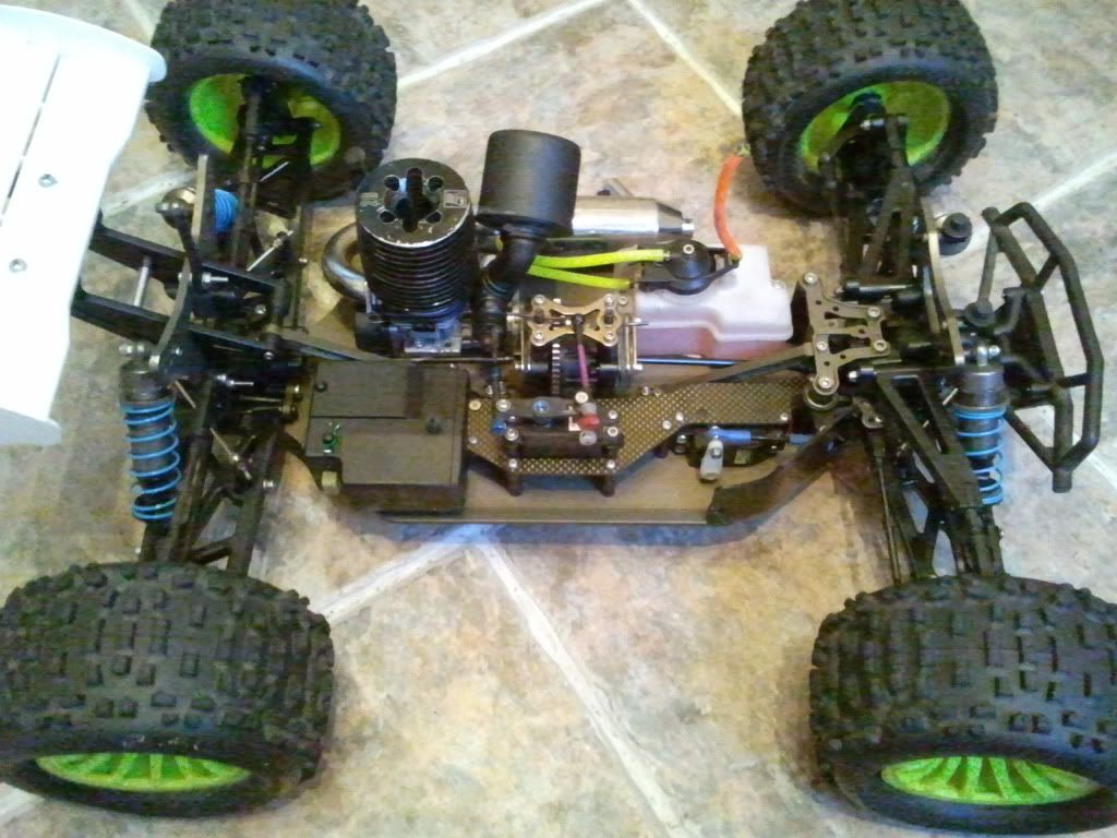

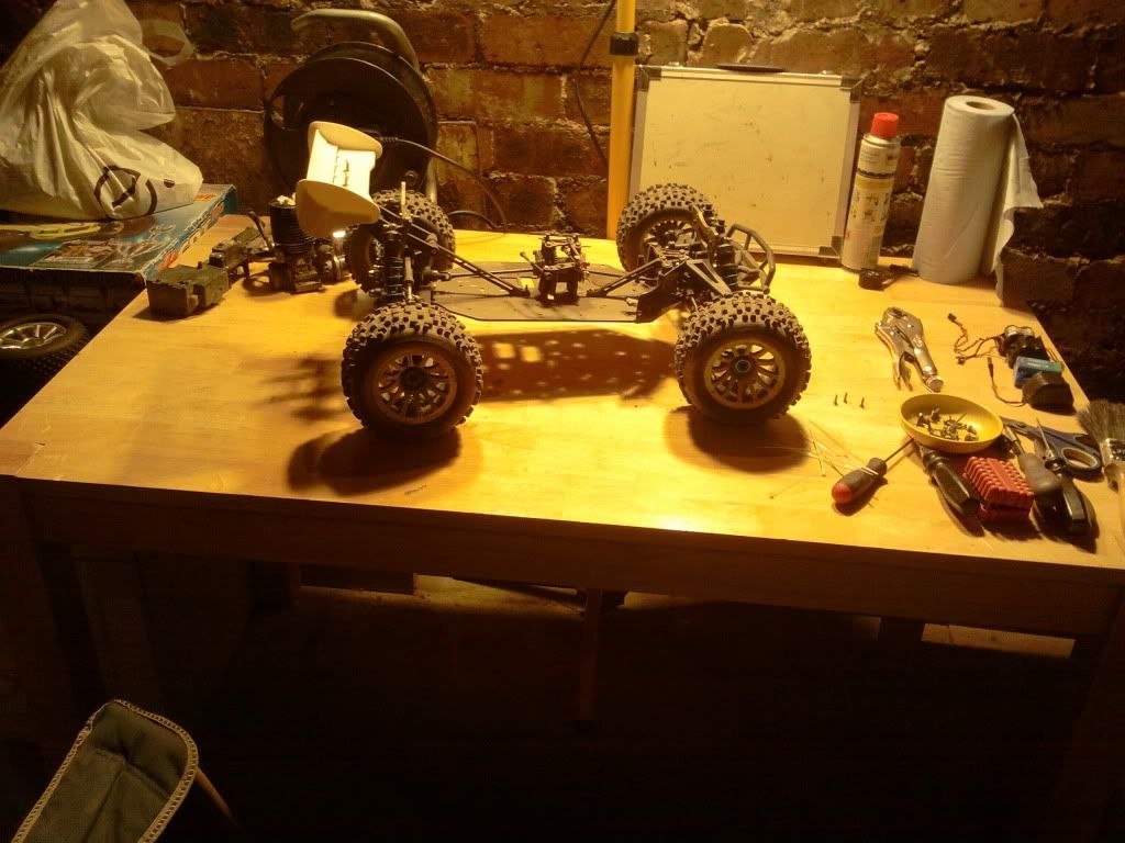

So After Many hours on here
It has now had a Complete Strip, clean and re-build
New Oils All round
5000 wt diff oil in the rear
30.000 wt diff oil in the centre
30.000 wt diff oil in the front
55wt shock oil in the front shocks
50wt shock oil in the rear shocks
New Clutch bell
New Alloy clutch shoes with Gold springs
New clutch bearings
Another shim under the head
Many MANY new bolts, as there were loads wrong, rounded , or snapped off
Tires re-glued
New silicon seals on the rear of the engine, and the centre joint of the exhaust
Air filter stripped an cleaned with fresh oil
A HUGE re-tune

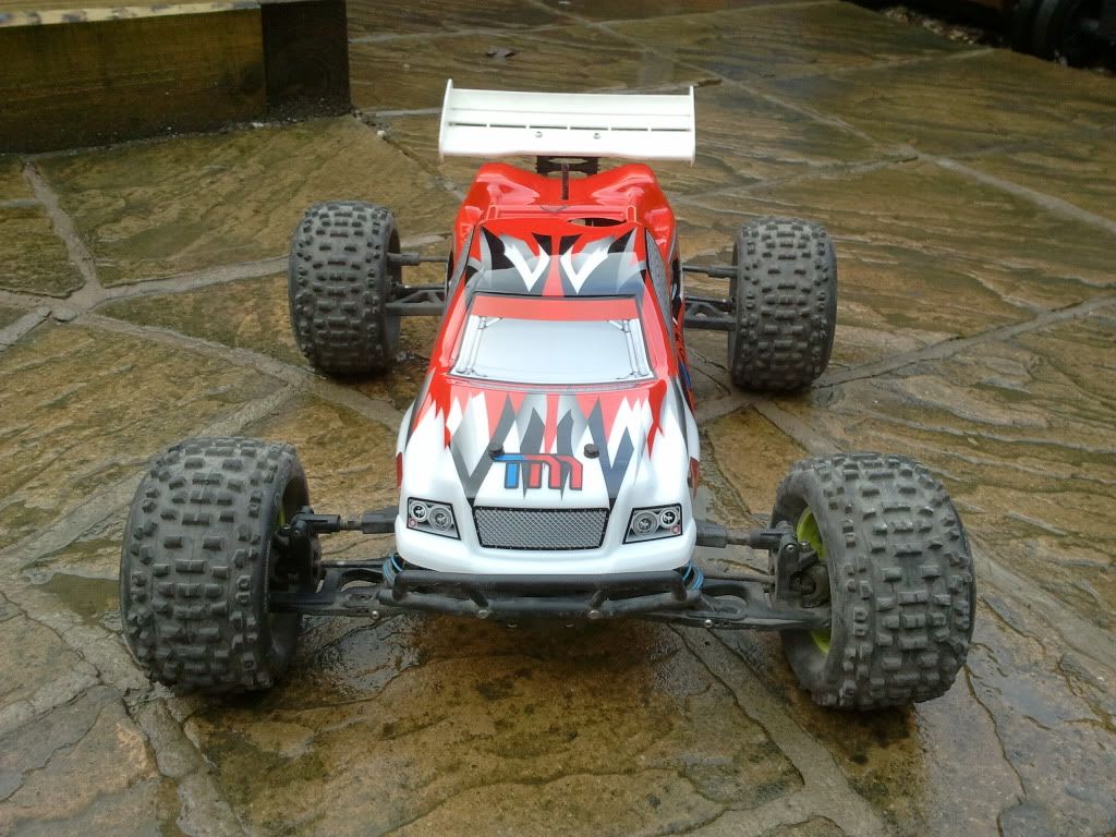

And a nice New Shell
So it's now looking like This wink
I'm happy with the end results
And it's going like stink, an handling awesome GOOD
Hope you like it smile

your not wrong yanto lol haha , which bolts where snapped off and rounded ? i know of a couple in the engine mounts thats about it for snapped ones , rounded was the exhause stay post thingy me bob and i think chassis side for the center diff ? , did you get a new rear bulkhead ?
